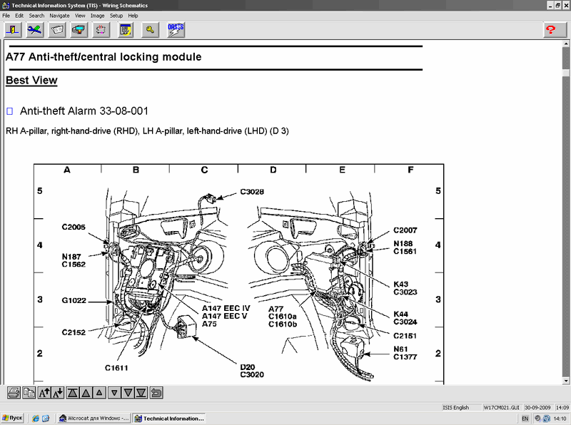

СообщениеДобавлено: Ср сен 30, 2009 16:19
Шоб не совсем разводить треп подкину картинку из ТИСа по твоей сигналке. Схем там слишком много страниц, потому кидать не буду - муторно это.

Я бы в первую очередь в таком случае заглянул бы в разъемы модуля А77 на схеме выше (в ногах водителя блок) на предмет воды/окислов, и особенно внимательно ознакомился бы с его заземляющим проводом - идет на болтик рядом куча проводов (земля G1001 по схеме). Вот еще кое-что по теме:
There are two possible central locking systems available: single locking and double locking.
Single Locking only
The central locking system with single locking does not require a module. The four door lock motors (M20, M22, M67 and M68) are electrically connected. When one of the front doors is mechanically locked or unlocked, current flows to the three remaining door lock motors and activates them.
Double Locking
The single locking process for the four doors functions as described above. The tailgate release motor (M85) can only be activated with double locking.
To activate the double locking system, the key must be turned first to the "unlock" position and then to the "lock" position within 3 seconds. These signals are sent from the door lock switches (N204 and N205) to pins 10A, 11A and 15A (for models before MY 95) and 13A, 16A and 14A, respectively (for models before MY 95), of the anti-theft/central locking module (A77). The module does not activate the system unless it receives the "door closed" signal from all of the door control switches (N174, N175, N176 and N177) at pins 6A, 8A, 7A and 5A, respectively.
The anti-theft/central locking module (A77) controls the door lock motors (M20, M22, M67 and M68) from pins 1A, 2A, 5B, 6B and 7B and the tailgate release motor (M85) from pins 22A and 9B.
With the system activated, the interior door handles and tailgate release lever are disengaged from the lock mechanism. An intermittent tone from the double lock set/anti-theft ON buzzer (H6) connected to pin 12A of the anti-theft/central locking module (A77) indicates that the system is activated. A continuous buzz indicates an error.
The function indicator lamp is integrated in the clock (A39). When the ignition is switched on, a signal is sent from pin 20A of the anti-theft/central locking module (A77) and illuminates the indicator lamp for 5 seconds. If the system is defective, the lamp remains lit for 20 seconds.
Voltage is applied to pin 3B of the anti-theft/central locking module (A77).
