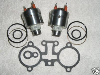

Во, нашел интересный лот:
Fully reconditioned and flow matched GM TBI injectors 55pph 5.7L injectors GM injector part # 5235206. Fits 1987-95 GM twin injector TBI motors V6, V8, 2.8L, 4.3L, 5.0L and 5.7L. This is a significant upgrade for your 5.0L motor (305 came stock with 40pph injectors) or your 4.3L V6, is a drop-in replacement for your 5.7L V8. Big upgrade for you 2.8L guys.
Fits the following applications: 1987-95 mid and full size Chevrolet / GMC trucks w/ 5.7L. 1987-92 TBI Camaro and Firebird w/ 5.0L. Caprice, Roadmaster, Astro, Safari, S10, Blazer. Will fit other GM TBI applications, please email if you have specific fitment questions.
This has been fully reconditioned with the following operations performed:
Electrical test consisting of amperage draw test during operation. This is much more thorough than a simple ohm test and no other ebay seller offers this
Injectors ultrasonically cleaned and spray pattern checked
Back flow cleaned to remove any contaminates that can't get past the nozzle....no other ebay seller does this operation
Flow match to within 5% - stock can vary by more than 10%
Injector bodies polished.....please note....some injectors will have discolorations from ethenol use
New injector o-rings and pod gaskets included as shown
At stock pressure, this will supply enough fuel for motors up to about 240hp, or you can upgrade to our adjustable fuel pressure regulator for motors up to 325hp. Please note, the figures below are estimates and will require some PROM work if you have made major modifications to your motor.
run at stock fuel pressure 10-12psi - for 180-240hp motors
16psi - for up to 280hp
20psi - 300hp
25psi - 325hp
If you have done exhaust and/or intake work on your 5.7L - you will want the extra fuel this puts out
This is a stock photo we use for several injector types and your actual product may vary...however, function will be exactly as stated
Две форсунки на 2,8 - по одной на каждые 1,4. :)
Теперь мы знаем, что они работают на давлении от 0,7 bar до 1,7 bar.
При этом увеличением давления достигается увеличение производительности.
5,7L_GM_TBI.jpg [ 24.67 КБ | Просмотров: 7077 ]
