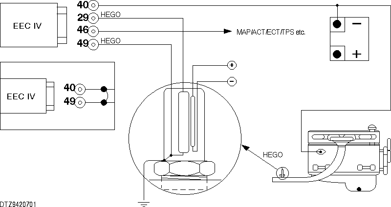

9. a. Check the HEGO sensor earth(Vehicles manufactured before 12/92)
NOTE:
All electrical loads must be switched off.
The EEC IV module must not be connected.
The Breakout Box with the Y-lead must be connected.
-- Measure the resistance between pins 40 and 49:
-- If the resistance is infinite (open circuit), go to step 9.b.
-- If the resistance is greater than 1,5 Ohms, solder in a bridge (wire with ø 1,5 mm) approx. 10 cm behind the 60-pin multiplug between the wires of pins 49 and 40 (see Fig. 1). Insulate the soldered areas.
Fig. 1

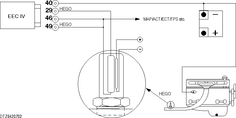

9. b. Check the HEGO sensor earth(Vehicles manufactured from 12/92)
NOTE:
-- Measure the resistance between the pins 46 and 49:
-- If the resistance is infinite (open circuit), check the wire from pin 49 to the HEGO sensor multiplugfor contact.
-- If the wire is functioning correctly, solder in a wiring bridge, as described in step 9.a. (between pins 49 and 40).If the resistance is smaller than 1,5 Ohms, the HEGO sensor is functioning correctly.
Fig. 2

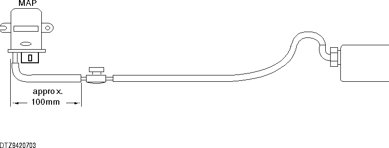

10. Check the vacuum line of the MAP sensor
-- Check if the new MAP sensor (fuel resistant), part number E7DF 9F479 A2A is fitted. If not replace MAP sensor (see Parts Required) to the above mentioned level.
-- Rework the vacuum line from the inlet manifold to the MAP sensor as shown in Fig. 3.
-- Fit the breather valve into the vacuum line approx. 100 mm in front of the MAP sensor.
NOTE:
The existing fuel trap is eliminated by this action.
Fig. 3

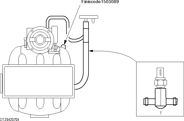

11. Relocate the engine coolant temperature (ECT) sensor (improves the fuel consumption mainly on short journeys)
11. a. Escort/Orion '91:
-- Relocate the ECT sensor refering to «TSB 108/1994» or to step 11.b. as detailed below.
11. b. Fiesta and Escort/Orion '86:
-- Relocate the ECT sensor by means of the T-piece, as shown in Fig. 4 (see Parts Required).The coolant hose leading to the heater must be cut approx. 50 mm before the enlarged section, otherwise the T-piece cannot be secured and the hose would have to be replaced.
NOTE:
With the ECT sensor inserted into the heater supply line, the operating temperature is signaled faster to the EEC module.
-- Connect the ECT plug.
Fig. 4

20. Check that the HEGO sensor is functioning properly
-- Start the engine and let it run for at least 3 minutes at approx. 3000 rev/min.
-- Set the analog voltmeter (multimeter with a dial hand) to 1 - 2V DC. Measure the voltage between EEC IV pins 29 (HEGO sensor (+)) und 49 (sensor earth (-)). The dial hand of the analog voltmeter should now read between 0,0V and 0,85V at least once a second (or vice versa) and the second afterwards return almost to the initial value. This process should repeat itself constantly without interruption.

Картинки из статьи.
Fig.1.GIF [ 9.04 КБ | Просмотров: 11275 ]
Fig.2.GIF [ 7.95 КБ | Просмотров: 11275 ]
Fig.3.GIF [ 3.68 КБ | Просмотров: 11275 ]
Fig.4.GIF [ 8.13 КБ | Просмотров: 11275 ]

СообщениеДобавлено: Вт окт 25, 2011 4:14
Апну сабж.
Чёта я не понял, что они рекомендуют вкорячить в вакуумный шланг МАПы.
Моя сдохла. Цены в экзисте саавсем не кошерные... Facet за сотку $ предлагают... про оригинал даже говорить страшно... ::doh::
